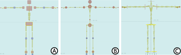

To change the appearance of existing Control rig effectors:
  1. In the Character Controls window, select > Edit > Controls > Rig Look, then select the effector type you want:
Rig Look A. Box B. Stick C. Wire
