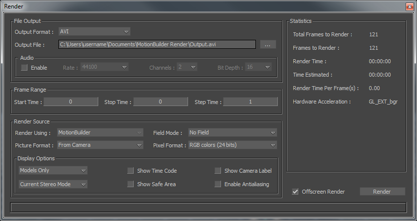

Rendering a scene
You can use the render window to create test clips or stills of your animation.
To render a scene:
  1. From the menu bar, choose File Render.
    The Render window appears.
    Render window
    Note:
    If your current video buffer mode does not support an Alpha channel, a warning message appears each time you open the Render window. Click Hide this Message if you do not want this message to appear again.
  2. Click Browse to set the destination path for your rendered file(s).
  3. Set a start and stop time in the Render window’s Start and Stop Time fields.
  4. Set a Picture format.
    See Render Source.
  5. Select an output format from the Output Format menu.
    See Render Output format.
  6. Click Render Movie. Depending on which output format you select, a window may appear with specific compression formats settings. Adjust these as needed.
  7. Click OK.
    The selected segment of the scene is rendered into the format specified in the Output Format menu and saved to the destination specified in the Render window Output File field. A window appears to tell you the scene has rendered successfully.
