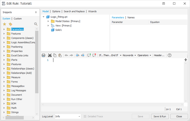

Now we can begin to create a rule containing the iLogic commands that define the model. We can create multiple rules, each with unique steps, or we can create a single rule containing all the steps required to build our model. In this case, we’ll create a single rule.
You will see that the Main rule has already been created. This rule must exist in parallel to all other rules you create. For the purposes of this tutorial, just be aware that this rule must always be present. The main rule is used for
