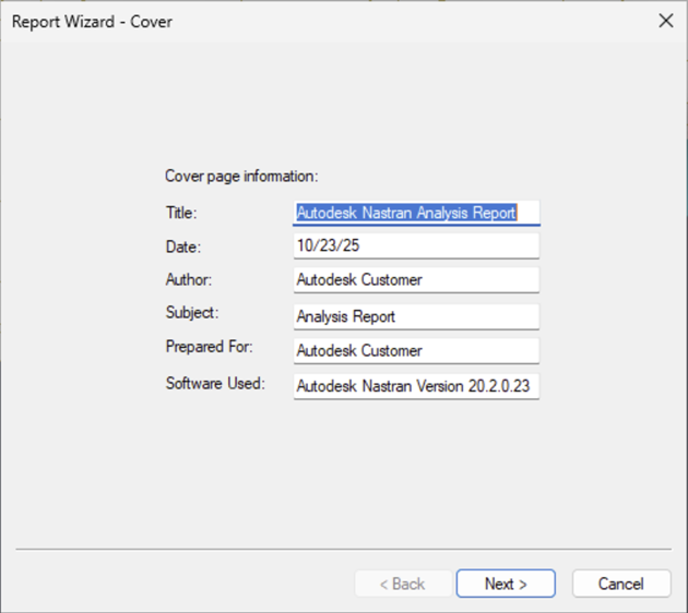

Report Wizard – Cover window opens. Fill in desired information and click
Next >.
- Title: Enter the title of the report.
- Date: Enter the date the report was created.
- Author: Enter the author of the report.
- Subject: Enter the subject of the report.
- Prepared For: Enter who the report is prepared for.
- Software Used: The software and version used is automatically generated.

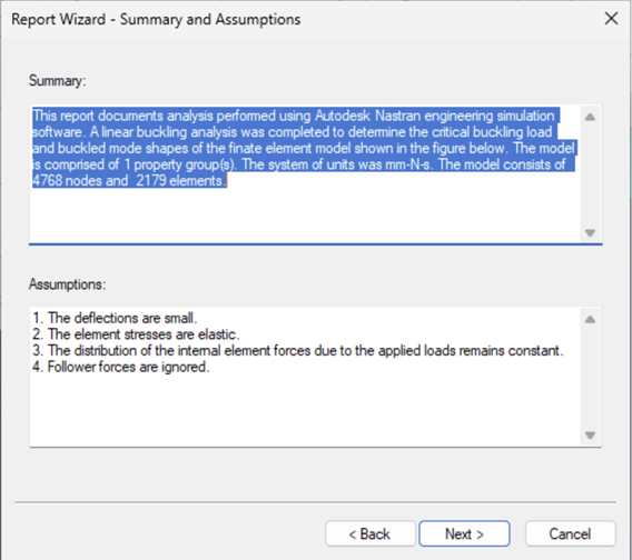

The
Report Wizard – Summary and Assumptions window appears. Edit and add desired information and click
Next >.
- Summary: Summary is automatically generated providing a summary of the analysis, including the analysis type, number of model properties, the unit system, and the number of nodes and elements in the mesh. Additional information can be typed in directly or copy and pasted from another program.
- Assumptions:
Lists the assumptions made for this analysis. The list can be edited in this step, but can also be changed by altering the default settings.

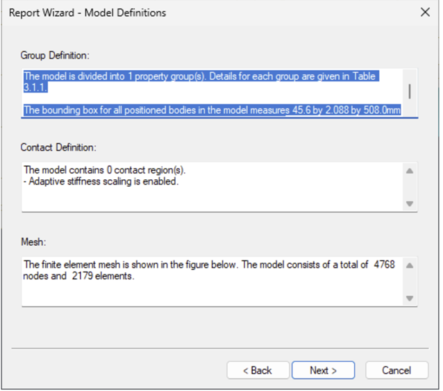

The
Report Wizard – Model Definitions window appears. Edit and add desired information and click
Next >.
- Group Definition: Content automatically generated, providing property details, and the dimension of the bounding box. Text can be edited.
- Contact Definition: Content automatically generated, listing number of contact regions and contact types. Text can be edited.
- Mesh: Content automatically generated, listing number of nodes and number of elements in the mesh. Text can be edited.

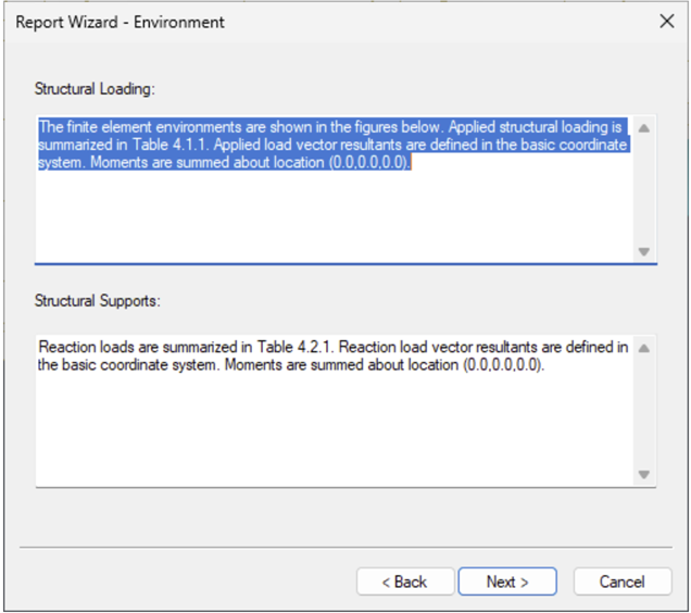

The
Report Wizard – Environmental window appears. Edit and add desired information and click
Next >.
- Structural Loading: Content automatically generated, providing a summary of the applied loads, and the location about which the moments are summed. Text can be edited.
- Structural Supports: Content automatically generated, providing a summary of the reaction loads, and the location about which the moments are summed. Text can be edited.

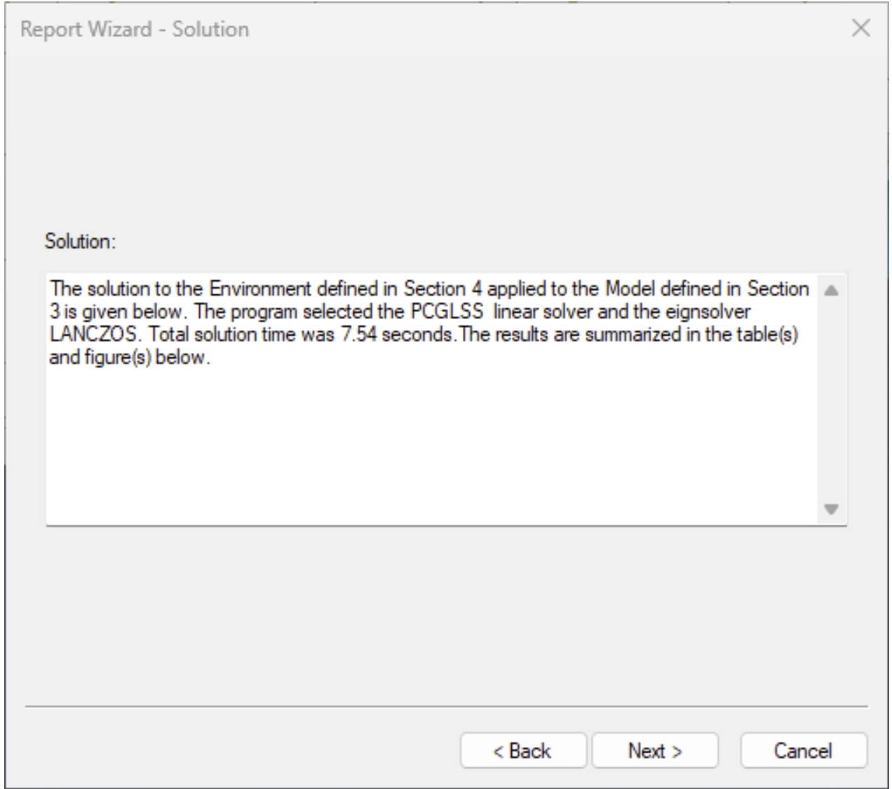

The
Report Wizard – Solution window appears. Edit and add desired information and click
Next >.
- Solution: Content automatically generated, providing total solution time and largest solution error with corresponding subcase. Text can be edited.

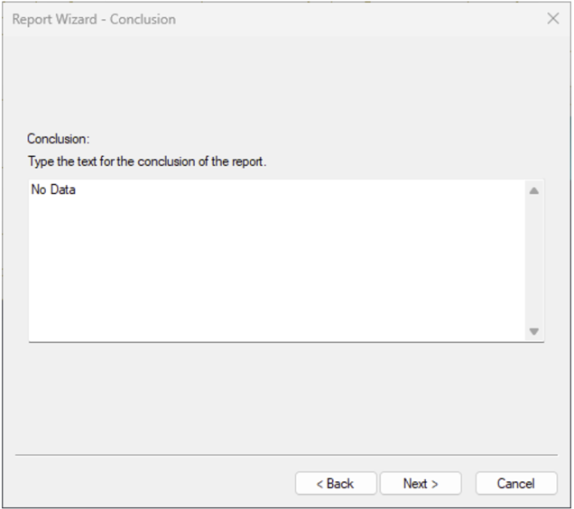

The
Report Wizard – Conclusion window appears. Edit and add desired information and click
Next >.
- Conclusion: Content automatically generated, providing the type of analysis, software version used, number of degrees of freedom, maximum displacement, maximum von Mises stress. Text can be edited.

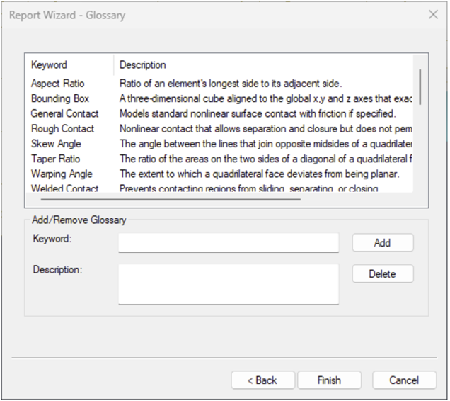

The Report Wizard – Glossary window appears. The available fields can be used to add/delete glossary terms, but you can also add/delete glossary terms by altering the default settings. Click
Finish to generate report.
Next >.
The
Next >.
- Assumptions:
Lists the assumptions made for this analysis. The list can be edited in this step but can also be changed by altering the default settings.
The
Next >.
The
Next >.
- Solution: Content automatically generated, providing total solution time and largest solution error with corresponding sub-case. Text can be edited.
The
Next >.
Next >.
The
Next >.
- Assumptions:
The
Next >.
The
Next >.
The
Next >.
The
Next >.

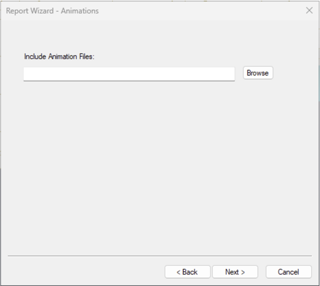

The Report Wizard – Animations window appears. Animation files can be added to the report for visualization. Add the proper animation file and click
Next >.
