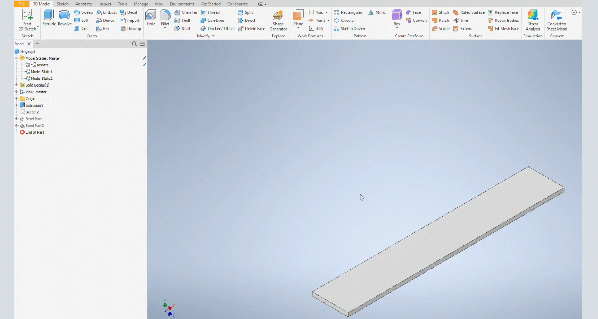

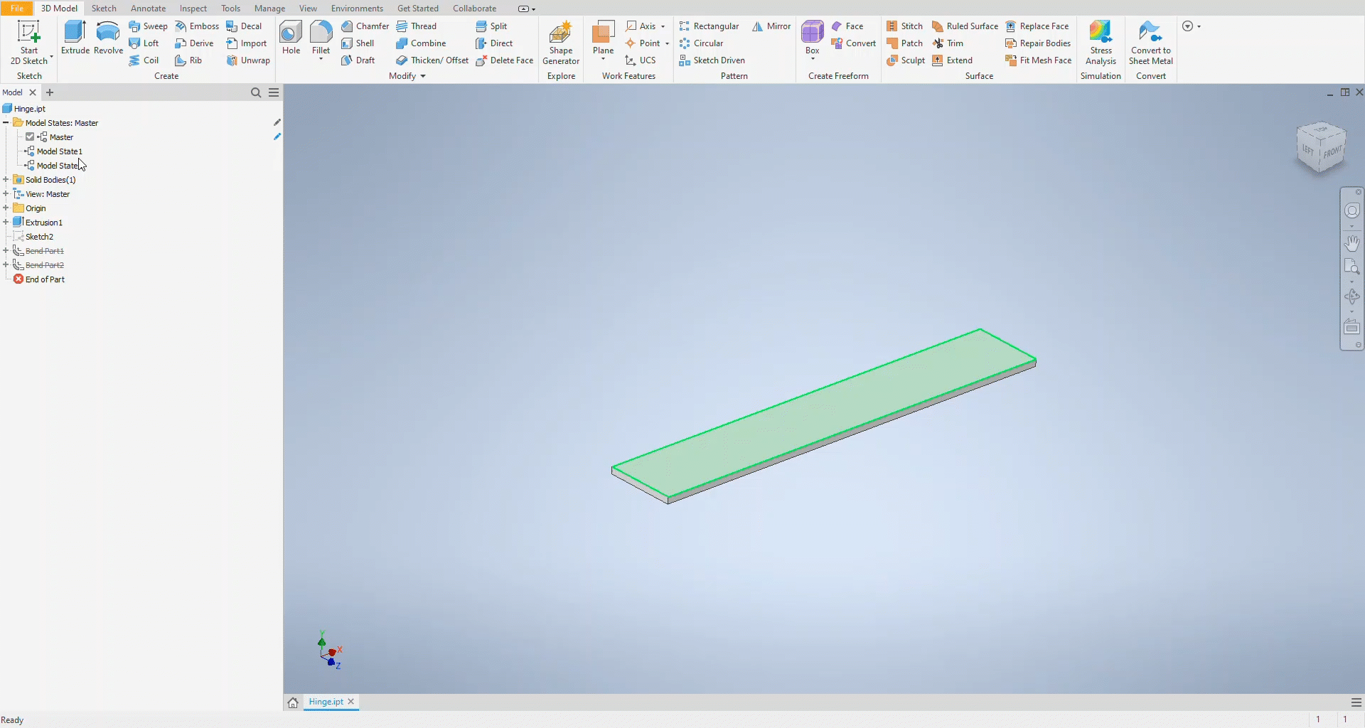

Inventor Nastran supports the Model State functionality recently introduced into Inventor, allowing users to define multiple states in one document. Inventor Nastran support applies to Inventor parts and assemblies. Legacy assembly Level of Detail will be migrated to Model State. In the New/Edit Analysis dialog box, Model State tab, Level of Detail is replaced with Model State.
The following two videos show basic operations with different model states.

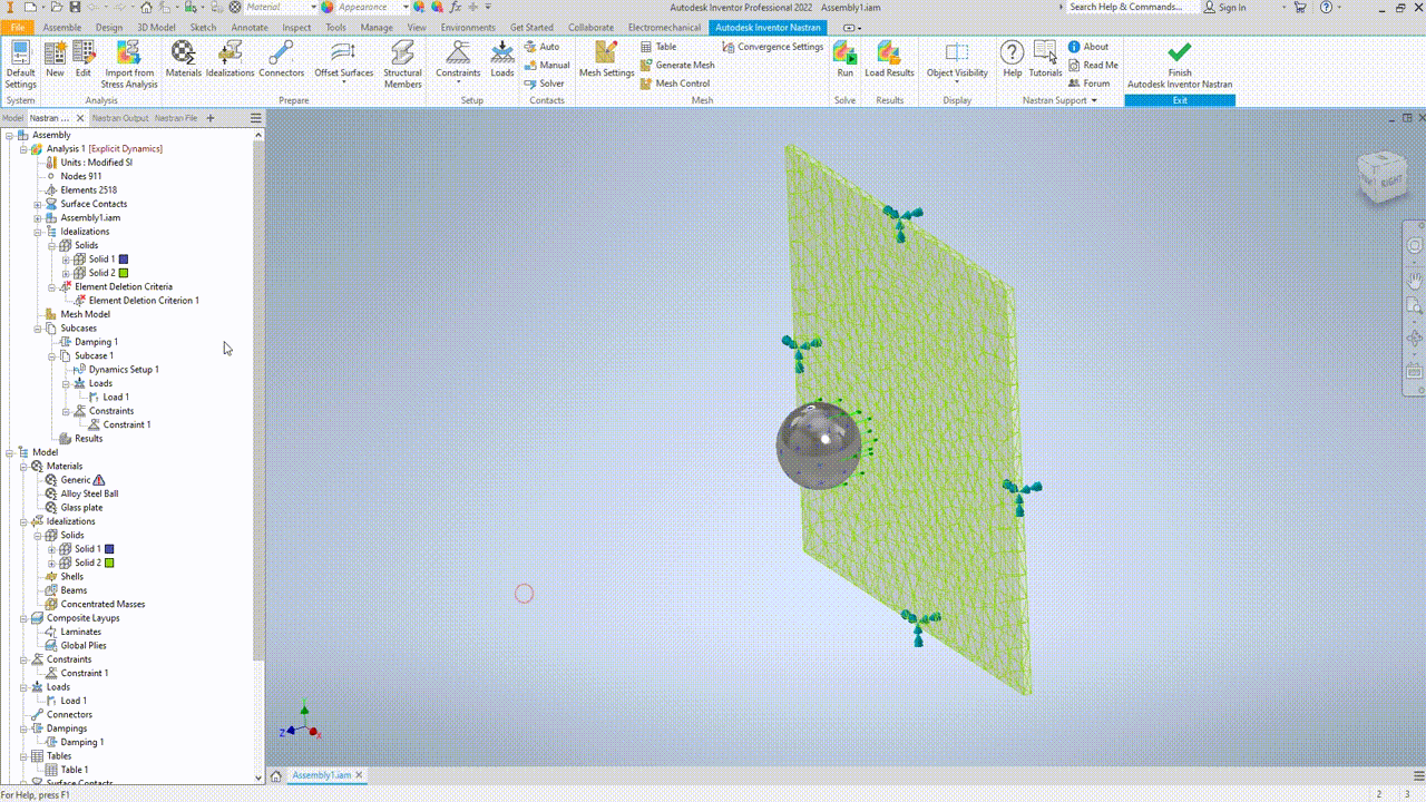

Explicit Analysis is improved in three key areas, for both explicit dynamics and quasi-static analyses:
Inventor Nastran now supports Hyperelastic material for Explicit analyses with advanced material properties such as Mullin's coefficient. For more information, see MATHP (Hyperelastic Material Properties).
Inventor Nastran now supports adding Drucker-Prager yield criterion in non-linear material property for Explicit analyses.
Inventor Nastran now supports adding Brittle material to Explicit analyses, which can help in creating materials like concrete and glass for Explicit analyses. For more information, see MATB (Brittle Failure Material Model).
