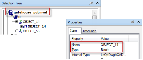

You can configure the Revit file conversion parameters to change the way the file is displayed in the Selection Tree. For example, you can divide the file into levels to organize the model hierarchy by File at the top level, down to Category, Family, Type, and Instance. See Divide Revit Files into Levels. Also, for Revit files, sub-parts are named according to the material from which they are made. For example, a wall may be broken up into sub-parts composed of asphalt or aluminium.
When using Revit 2022, you have the option of using either the original room geometry or converting it into construction sub-parts in Autodesk Navisworks. Also, room items within the Revit file have their own Rooms category in the Properties window. See To Convert Room Geometry.
