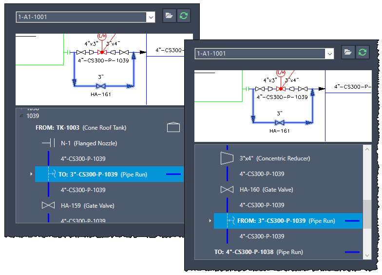

Line List Panel
Displays the lines and inline components available to be placed in a 3D model.
- Line List Toolbar
- Provides buttons that open and refresh the status of drawings.
Open. Opens the selected P&ID drawing.
Refresh. Refreshes the line list and line components of the selected P&ID drawing.
- P&ID Preview
- Provides a preview of the selected P&ID drawing from the dropdown list.
- To change the color of the preview area, right-click the preview area and select Invert Background Color.
- Tree View
- Each node in the tree represents a line group in the P&ID drawing. The inline components, branches, off page connectors, start/end equipment and nozzles associated with each line group are ordered according to the flow direction of the pipeline.
- Branch: Each branch of a line segment is listed in the tree view, with the flow direction clearly identified.
- The branch is represented by an icon and prefix, indicating whether it is an outlet (TO)
or inlet (FROM)
- By expanding a branch, you can view the line segments, inline components, and the start/end points of the branch.
- Off-page connectors (OPC): Off-page connectors are identified with an icon
and prefix indicating the flow direction, outlet (TO) or inlet (FROM).
- For line groups that are connected by off-page connectors across multiple P&ID drawings, the start/end components from another P&ID drawing are displayed in the tree view.
- To view the connected line segment, double-click the off-page connector.
