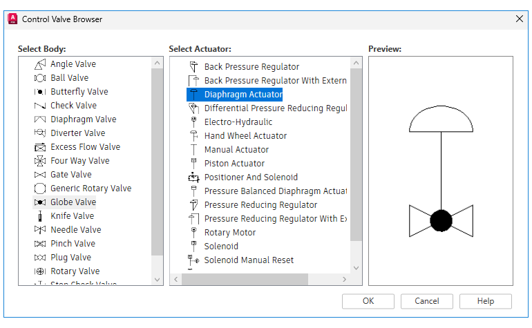

  4. Do one of the following:
    • If you are adding a control valve to a project for the first time, the Control Valve Browser dialog box is displayed. Select a control valve body and an actuator and click OK. A preview is displayed when selecting a body or actuator. In the drawing area, click to place the control valve. When prompted, click again in the drawing to place the annotation.
    • If a preview of the currently active control valve body and actuator is displayed, change the body type or actuator. Right-click and select Change Body or Actuator. Click the drawing area to place the control valve. When prompted, click again to place the control valve annotation.
