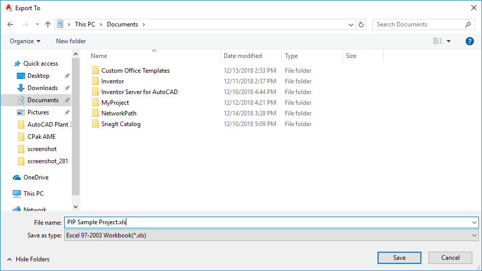

Specifies a file name, file path, and file format for the data or report you export.
Toolbar: Data Manager
Right-click a data node
Export
Browse. Data Manager tree view in Project Reports mode
Right-click a report type
Export.
Specifies the folder to store the exported data or report.
Specifies the file name for the export. The name cannot be more than 31 characters long.
Sets the file format for the export. Options are:
Use Microsoft Excel 2003 or later to view and edit the exported spreadsheet.
Use Microsoft Excel 2007 to view and edit the exported spreadsheet.
Use a text editor such as Notepad to view and edit the exported comma-separated value files.
Saves the file name, file path, and output format settings for the export.
