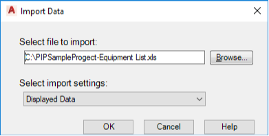

Data Manager.Make sure to select the node that corresponds to the worksheet or CSV file containing the data you want to import. If you select a node that does not correspond directly to the modified worksheet or CSV file, the import ignores the changes.
The message indicates the location of the log files for accepted and rejected edits from the imported spreadsheet or CSV file. You can click the link in the message to open the folder. After you accept and reject edits, you can access the log file in the folder.
To import data from another program, click the appropriate custom setting. (Custom settings are unavailable, however, if you are importing into an area or customized view.)
