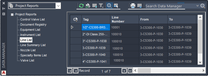

The following table describes the default reports in Project Reports:
| Report | Contents |
| Control Valve List | Data about control valves, the drawing where they are located, the line number, sizes, and so on. |
| Document Registry | Data about drawings in the project. |
| Equipment List | Equipment components and the drawing where each component is located. |
| Instrument Index | Data about instruments, the drawing where they are located, and the object to which they are connected. |
| Line List | Data about piping segments grouped by line number and the drawing where they are located. |
| Line Summary List | Data about the pipeline groups and the drawing where they are located. |
| Nozzle List | Data about nozzles, equipment, the drawing where they are located, and the line (segment and group) to which they are connected, if any. |
| Specialty Item List | Data about specialty items such as steam traps, cone strainers, and so on. |
| Valve List | Data about valves, the line segment, or group where they are located, and the drawing location. |
If you choose to build reports using the Data Manager, you can create new report types based on existing report templates. The templates include lists of equipment, lines, line summaries, instruments, valves, nozzles, and so on.
After you configure a report, the properties you specify are queried. You can view the results in the Data Manager.
