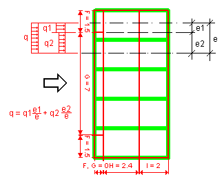

For a 2D structure, a linear load on a bar is calculated as a product of wind pressure q and the distance between frames, that is, spacing e. For the outermost frame, one-half of the spacing is considered. A wind load according to the EC1 code, is generated separately for each of the repeating frames, because the code designates successive zones (A, ... , J) of different wind pressure. If a given frame and its spacing belongs to more than one zone, the value of pressure q is calculated in proportion to the frame participation in each zone (as shown in following image).
