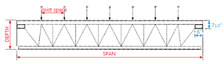

A joist girder is a simple span, supporting equally spaced concentrated loads from open-web steel joists. These concentrated loads are considered to act at the panel points of the joist girder.
Joist girders are designed to allow for the efficient use of steel in longer spans. Various weight tables developed by the manufacturers (for example, Vulcraft) list joist girders from 20 inches to 96 inches deep and spans up to 100 feet. The standard configuration of a joist girder is parallel chords with underslung ends and bottom chord extensions.

There are three main types of point load distribution for joist girders: G, VG, and BG, as shown in the following figure.
