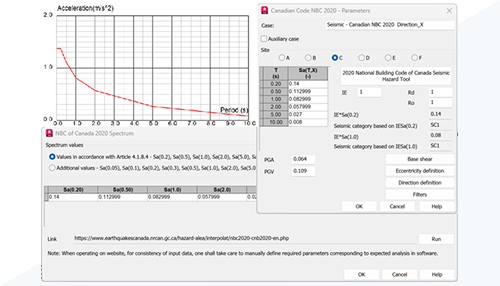

Seismic Analysis for Canada
The current Canadian code NBC 2020 was implemented for seismic analysis.
The implementation includes two methods with updated parameters for analysis and comprehensive analysis calculation notes
All the codes are set as default in the relevant regional settings.
To find this new seismic code:
  1. Click Tools Job Preferences Design Codes.
    The Job Preferences dialog opens.
  2. Select Loads in the left panel of the Job Preferences dialog.
  3. Click the Seismic loads drop-down list to see the list of available codes.
