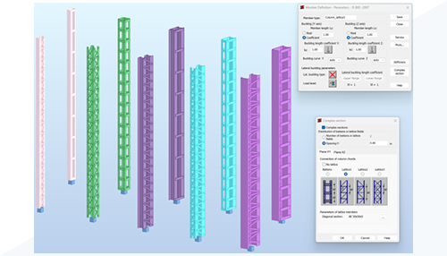

IS:800:2007 implementation was updated and extended to include complex section.
Robot Structural Analysis 2026 introduces the following changes for the Indian market:
  • Update of the IS:800:2007 by implementing amendments 2012 and 2024.
  • Implementation of complex sections design according to IS:800:2007.
