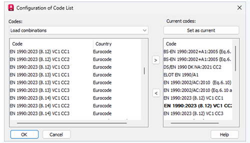

  1. Click Tools Job Preferences.
  2. In the Job Preferences dialog, under Design Codes, select Loads.
  3. Click the arrow in the Code Combinations drop-down list to see the list of available codes.
Note: The codes available in the drop-down lists depend on the country selected in the Preferences dialog. To configure the list of available codes, click the arrow, and then click More at the bottom of the list.
