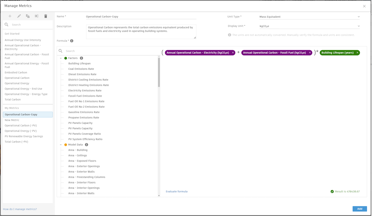

  1. From the Embodied Carbon Details dashboard, or a Custom Dashboard, select 'Metrics' from the 'Manage' dropdown list located in the upper right corner.
  2. In the Manage Metrics dialog, click the + icon.

  1. In the Formula section of the dialog, select necessary data points from the list. These selected points will then appear in the formula area.
  2. Use mathematical operators between data points to build the formula. Formula Example: The Metrics for 'Annual Operational Carbon' could be multiplied by the Factor 'Building Lifespan' to calculate the operational carbon used over the years in which the building is assumed to operate. On the custom dashboard, a dropdown card can be used to set the value for the 'Building Lifespan'.
ManageMetrics
Note: To remove a data point from the formula, click the 'X' to the right of the node title.
  1. (Optional) Click 'Evaluate formula' near the bottom of the dialog to test your formula.
    Note: Units in formulas are not automatically converted. Manually verify the formula and units are consistent.
  2. Click Add to create the Metric.
