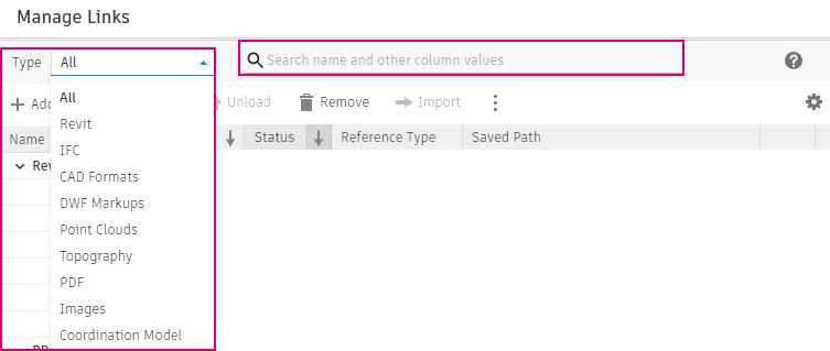

In the dialog, use the filter to show each type, and the Search function to find links.

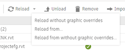

Use the operation tools listed at top for the desired actions, such as reload with or without graphic overrides, unload, and remove. They are dynamically generated based on the type and status for the linked file.

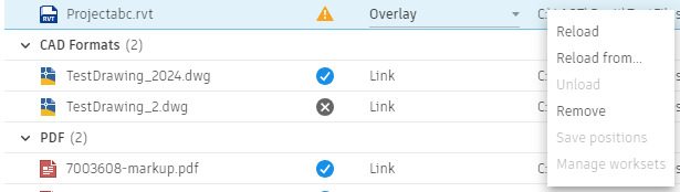

You can also use right-click the More button at the end of each row to access the same operations.

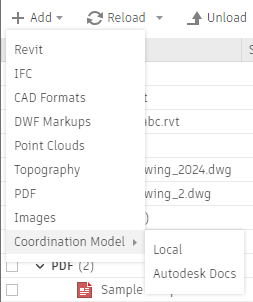

Click the Add button to bring referencing data into Revit.
