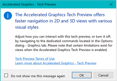

Make accelerated graphics available for use in views of your model.
  Tech Preview Accelerated Graphics is enabled by default. This can be disabled from the Revit.ini file. For additional information see:

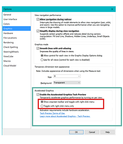

   To manually enable or disable access to Accelerated Graphics, go to Options dialog
Graphics tab
Accelerated Revit Graphics and select Enable the Accelerated Graphics Tech Preview. Once enabled, use the radio buttons to enable or disable how the accelerated graphics tech preview will be enabled in individual views.

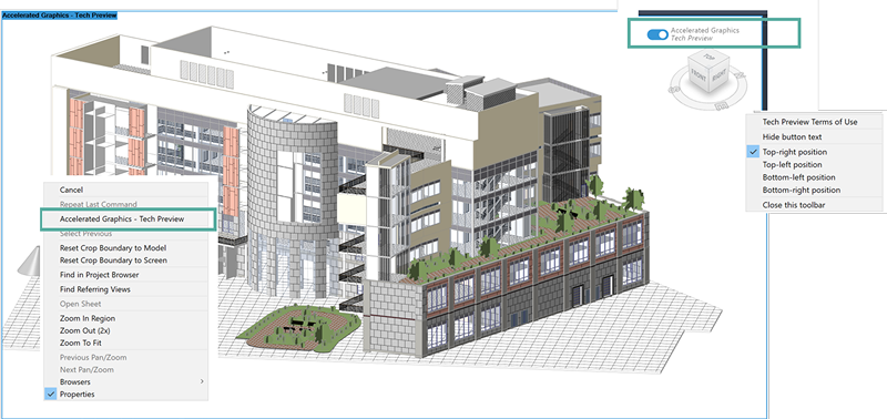

  - Show onscreen toolbar and toggle with right-click menu - Both the onscreen toolbar and right-click options are available to enable and disable tech preview accelerated graphics in a view.
- Toggle with right-click only - Onscreen control is not visible only right-click can be used to enable and disable tech preview accelerated graphics.

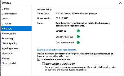

- GPU Enabled
		   - Accelerated Graphics will not be available if a graphics card is not detected.

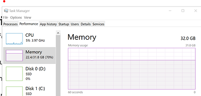

- Adequate RAM
- RAM shortages will impact all performance and display in Revit. Accelerated Graphics will not improve this.
- Enabling Accelerated Graphics in multiple views may increase memory utilization. Additional RAM capacity is recommended.
- Windows Task Manager may assist with total and available RAM statistics.
