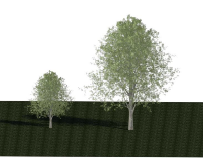

You can change the size of plants using type properties in a project. The updated plant size displays in 2D views, 3D views, and rendered images.
Note: You can also specify the size of a plant in its family.
Maple trees of different heights
