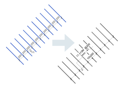

- Dimension rebar sets in structural elements inclined with respect to the view (e.g. ramp displayed in plan view). The rebar sets can be either free form or shape driven, and must be made up of single segment parallel bars, with or without hooks.

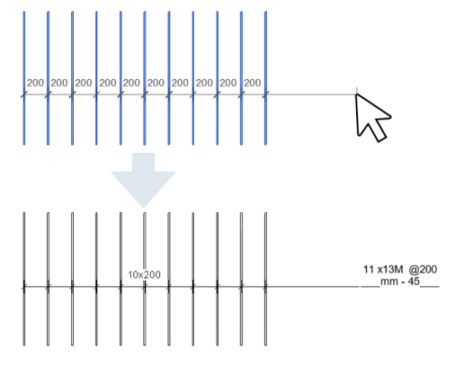

- Place Tags Automatically: To automatically place multi-rebar annotation tags, make sure that
(Pick Position) is toggled off in the Annotate tab
Tag Panel
(Multi-Rebar)
Modify | Multi-Rebar Annotation Aligned
Tag panel.
- The tag is automatically placed above or to the left of the dimension line, at the specified offset, when you click inside the line to place it:

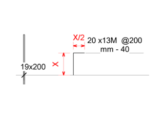

- Or the tag is automatically placed at the position where you click, when you click outside the dimension line to place it:
Tip: Space to flip the tag on either side of the dimension line.
