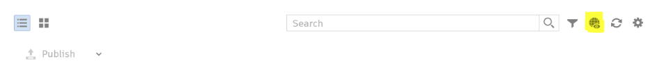

Use the
New Revit Home toggle button to switch between the classic and new homepage.
The new Revit Home provides more ways to view, sort and find models and versions.
Note: It does not show Project Templates and Component Libraries in the Autodesk Account Hubs.
