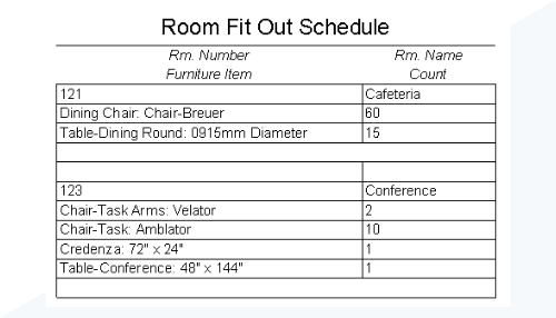

Use embedded schedules to show information about elements contained in room, spaces, or an MEP system.
An embedded schedule allows you to create a schedule category inside of a schedule of another category. In order to create an embedded schedule the top level category needs to be room, space, duct systems, piping systems, or electrical circuits. In the example above, a furniture schedule is embedded into a room schedule.
When you need to schedule individual parts of a greater system or components that fall into a room or space use an embedded schedule. For example if you were working on a hospital and wanted to track all of the equipment in each patient room, you might create an embedded schedule for these items appearing in each room. You might create a schedule for all the air terminals in a duct system.
