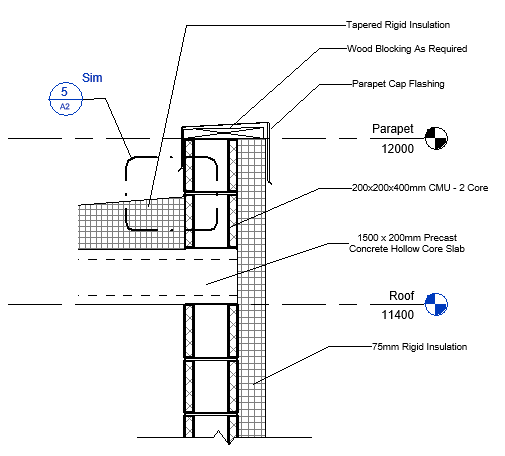

Learn how to use keynoting tools to help speed the annotation of your models.
used to annotate an element and then a legend
on the sheet or next to the drawing indicating what each number refers to. This made the bulk of the text needed to annotate all in one place so it was easier to hand letter and/or make changes when needed.
Once CAD came along, there was less of a need for keynoting because placing and editing text was easier. Keynotes were not used as much because they can be seen as confusing when reading a drawing. placing the text note directly next to elements in a drawing, a person reading the drawing did not have to look at the legend to find the value. Now, with BIM workflows and data being a part of every Revit family, you may want to look at keynoting again.
Everyone wants to increase their productivity. Annotating drawings is something that can take a long time, using the keynoting tools in Revit you can make this process much more efficient. As part of its' Identity Data under Type Parameters every family contains a parameter for a "Keynote". When you assign a value to this parameter, you can tag the element and read this value into the tag automatically. What prevents people from using the keynoting tool is the fact it needs to be set up ahead of time in order to maximize efficiency. If the keynote value is blank (as it is for the default families) you have to assign the value for each element in your model. Time spent setting up keynote values for your most commonly used elements may make keynoting a valuable tool for annotating your projects.
Another reason to consider keynoting is the ability to standardize your annotations and handle changes to specifications and annotations more easily. The keynote values assigned to families come from a keynoting text file. This outside file is more easily managed and standardized. If all projects use the same keynote file you can be sure all of you notes are consistent wherever they appear. If you need to make a change to the way a note reads, change the keynote file and reload. Everywhere in your model where that keynote value is used will be updated with the new value in the keynote file.
