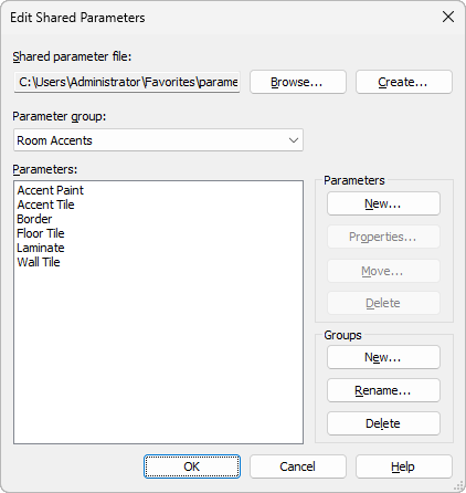

For more information on creating shared parameters and parameter groups see, Create Shared Parameter Files, Groups, and Parameters.

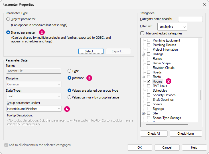

Now the shared parameters need to be added to the project and assigned to the Rooms category. This makes the parameter appear on the room elements in your model so you can populate the parameters with values.
is added to the Room category
in the project as an instance parameter
and set to group under Materials and Finishes
For more information on adding shared parameters to your project, see Create Shared Project Parameters.

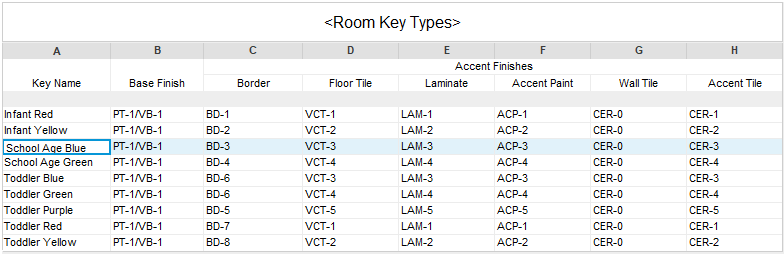

With the parameters available in the project, they can be added as project parameters as we did above, or they could be directly added to a loadable family that is loaded into the project. You can now create the key schedule. When you create the key schedule, you are selecting the parameters you want to control/assign via the key type. In our example, we will make key types for each room finish package. All the "Room Accents" shared parameters will be added to the key schedule. We will also add the built in parameter of base finish. In this case we are using it for the finish of the room before the accents are added.
For more information on creating a key schedule and assigning values, see Create a Key Schedule.

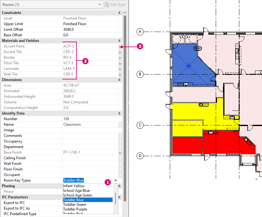

The final step is to apply the key types to the rooms. Select a room element, or multiple elements, in the model and on the Properties Palette, use the pulldown under the Identity section of the Properties palette
to set the room key type. The pulldown menu lists the key types defined in the previous step. As you set the key type, the parameters for room accents are assigned from the key schedule.
The small "equal" sign to the right of the parameter value
indicates the parameter value is controlled from the key schedule. If you later remove the key type from the room, the parameter values are retained, but can be individually controlled instead of being controlled from the key schedule.
For more information on applying a key to an element see Apply a Key to an Element.
