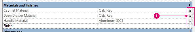

Once the material global parameter is created, assign it to the material parameter value in the cabinet families used in the kitchen layout.
  1. Select the element and locate the type parameter.
  2. Click the button to the right of the parameter and its value .
    The Associate Global Parameter dialog opens.
    Non-reporting global parameters that match both discipline and parameter type are available for selection.
  3. Select the material global parameter created from the previous steps to assign to the parameter.
  4. Click OK.

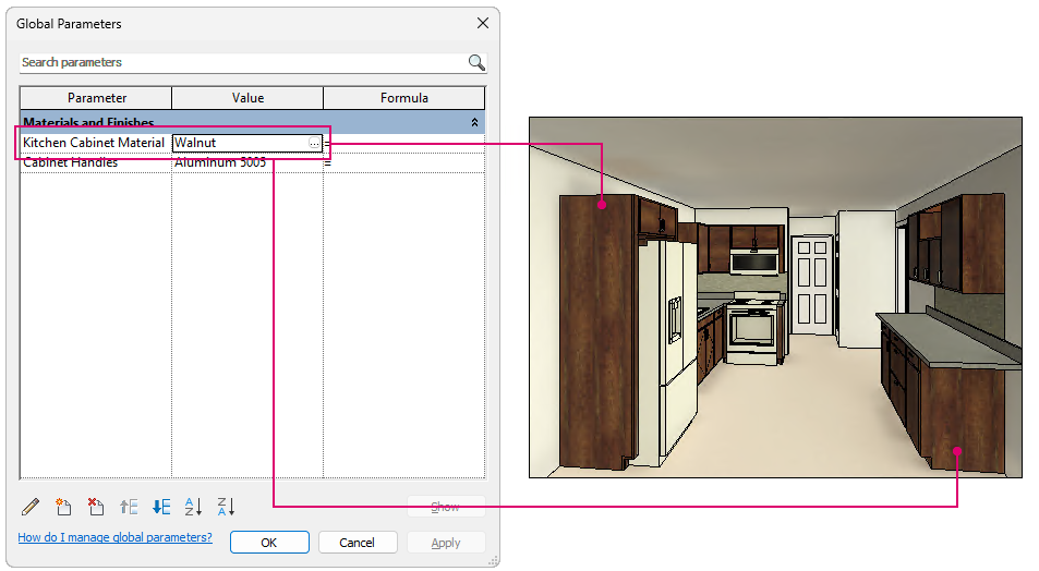

Once the global parameter has been assigned to the families, you are now able to control the material assignment for the families from the Global Parameters Dialog.
To modify the value of a newly-created material global parameter, click Manage tab Settings panel (Global Parameters). Choose a different material and it will be applied to the casework in the kitchen. You no longer need to modify the type parameters for each family individually.
