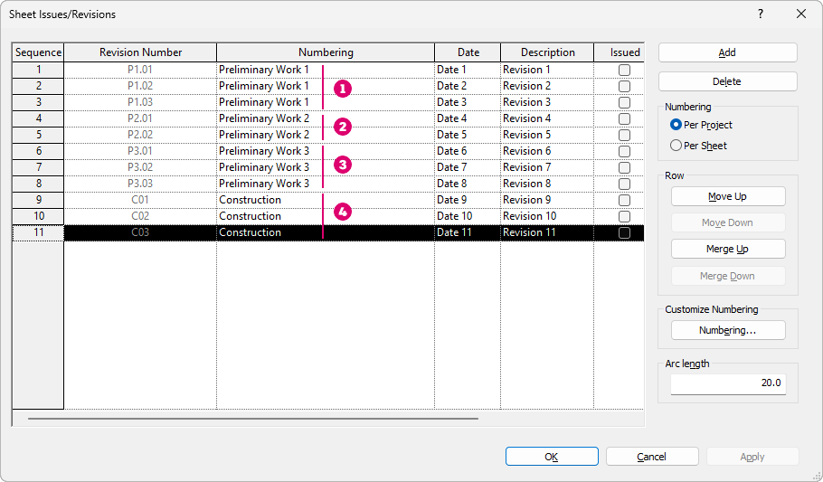

As an example, imagine you are working on a project that requires you to track revisions during the design phase and also track revisions separately during the construction phase. Each time a design review package is issued the revision is labeled with a prefix designation of P1, P2, P3, etc... Each marking a release of documents for review. Within each release, you need to document minor changes to the project made. The change made between design review releases are tracked using the prefix of the design release followed by a two digit number.
After documents are issued for construction, the revisions will be indicated with a prefix of C followed by a two digit number.
This revision standard can be accommodated with the revision numbering enhancements in Revit 2022.
In the image you see how the revision naming scheme previously described is created in
Revit. Each of the preliminary design phases gets a number sequence,
, and
. The number sequence is set to use two digits and each has a prefix of P1., P2., and P3. respectively. The construction numbering sequence
, uses 2 digits and a prefix of C.
