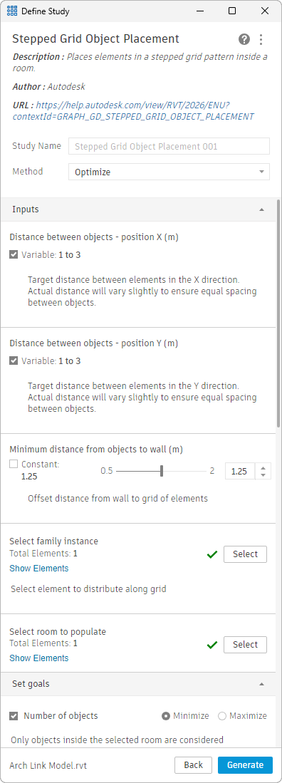

To find optimal layouts for the main dining area and the two outdoor spaces, use Generative Design in Revit. The Stepped Grid Object Placement study can help maximize the number of tables while also maximizing the space between seated patrons.
The stepped grid study uses room elements and a family instance to place in the room. In this case, use a nested family consisting of a table, chairs, and a dashed line indicating physical distance requirements. Select the variables for distance between the objects (tables) on the X and Y axes. The spacing establishes the grid and the placement of the family element based on the insertion point (origin) of the family.
The study applies a grid to the room. It places the table family in offset cells of the grid. Where part of a table instance falls outside the room, the study removes the family. (In this example, the edge of the room was redefined with a room separator to accommodate the banquet seating.) Generative Design iterates the placement of the stepped grid layout for multiple spacings on the X and Y axes. It also adjusts the origin point of the applied grid. Different grid spacing values and origin points result in alternative arrangements and varied numbers of tables in the room. To help visualize how the study iterates possible layouts, the following image illustrates the grid that Generative Design applies to the space.

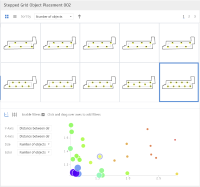

Use the Explore Outcomes dialog to examine the layout alternatives and to evaluate them for different criteria.
At the bottom of the dialog, use the scatter plot to find outcomes that meet your criteria. In this example, the grid spacing needs to be greater than 1.6 meters to meet the physical distancing guidelines. Lower values result in more tables, but they are too close together to meet the guidelines. More spacing results in fewer tables than required to make the restaurant financially viable. The overall goal is a balance between the number of tables and the physical distance between the tables.
For this example, you want to ignore values below 1.5 meters
, because the spacing is too close. You can also ignore outcomes that are further out on the scatter plot because they have too few tables
. In the following image, consider the results near the dashed lines as possible layout solutions.

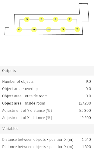

Based on these outcomes, the optimal layout has nine tables in two rows.
After selecting the optimal layout in the Explore Outcomes dialog, click Create Revit Elements. Revit places the elements in the model.
