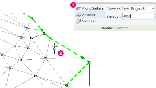

		Shape editing tools are used to manipulate the surface of a flat (non-sloped) floor or roof by defining high and low points for drainage. Shape editing tools are also used to create toposolid elements representing site features in models. You can set how elevations are measured during shape editing in the contextual ribbon.
 Elevations are displayed near the cursor during editing
, making it easier to edit accurately.

		  When adding points during shape editing, use the Elevation Base setting to define the relative elevation of the point. You can choose to measure elevations from the current level, the project base point, the survey point, and the internal origin. You can determine whether the points are added at an absolute elevation from the selected datum, or offset a specified distance from the existing surface.
