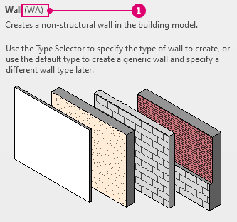

If nothing is listed in the tooltip, there is no keyboard shortcut assigned to the tool. A complete list of default keyboard shortcuts can be downloaded in PDF or XLS format. See Keyboard Shortcuts.
