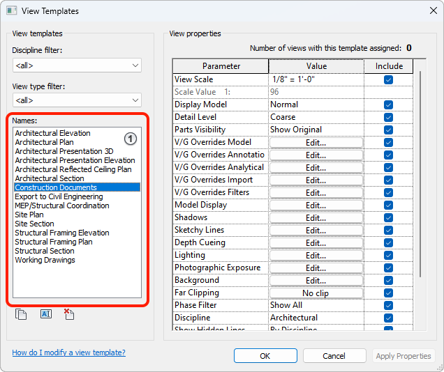

Manage View Templates - Open a dialog where you access all the view templates in your model and can make changes to the view property settings of each template. You can create new view templates from the dialog.

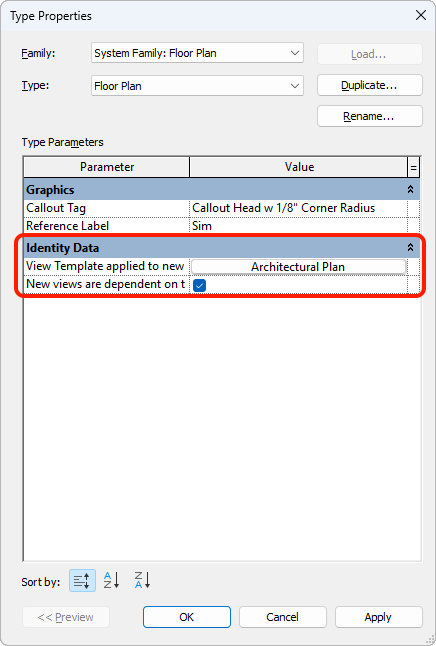

Set a view template to be applied when new views are created. In the Identity Data of a view type, a view template is assigned. When a new view of this type is created, the template will automatically be assigned.
When starting to use view templates in your projects, first create a number of view templates for different use cases. For example, create view templates for presentation views, construction document view and for coordination views. Once you have these view templates created, now assign them to individual view as needed. Having a template ready for each use makes it easy to assemble views for your needs and each view is displayed in a consistent way.
View templates can also be assigned to view types. If this is done, as you create views you eliminate the step of applying a view template after the view is created. As you crate the view, the correct template is applied based on the view type. When you apply view templates to view types, select whether the view will be dependant on the view template.

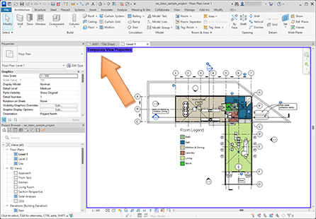

When view templates are assigned on the properties palette, or when you assign a view template to a view type and it is set as "dependent", all visual aspects of the view are controlled by the template. To change the appearance of a view, you must either, remove the template from the view, edit the template, or enable temporary view properties. When temporary view properties are enabled, a purple border is displayed on the view. Once in the temporary view properties mode, make changes to the appearance of the view as you normally would. You may find the need to do this when you need to check or coordinate something quickly but do not want to change the assigned view template. Click the temporary view properties button on the view control bar again to turn the mode off and return the view to the visibility settings from the applied view template.

View templates control many aspects of a view's appearance. Other aspects such as scale, shadows, or phase status can be included as part of a view template. All of the properties of a view controlled with a view template are displayed on the right side of the view properties dialog. When creating your view templates be sure to review all of the aspects of the view that are controlled so you can get as much as possible out of your view templates.
