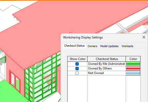

 Checkout Status

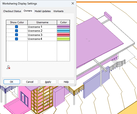

 Owners

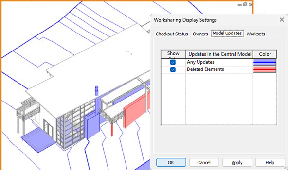

 Model Updates

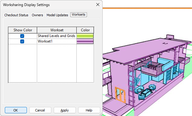

 Worksets
	 When a mode is applied to the view, the border of the viewport is displayed in orange. The name of the mode being applied appears in the upper left corner of the viewport. Switch from one worksharing display mode to another by selecting the control on the View Control Bar and selecting another mode, or turn the display off.
When you turn off worksharing display modes, the original display style settings are automatically reset.
Worksharing display modes work with ghost surfaces as well as edit modes. Note that in edit modes, elements such as sketch lines may display according to the color enabled in the worksharing display mode. You can turn the worksharing display mode on or off as needed to avoid confusion with edit modes.
Colors used for the Worksharing Display Modes are controlled in the Worksharing Display Settings dialog.
To assign color to specific criteria
Worksharing Display Settings.
The specified color for the corresponding criteria displays in the model.
