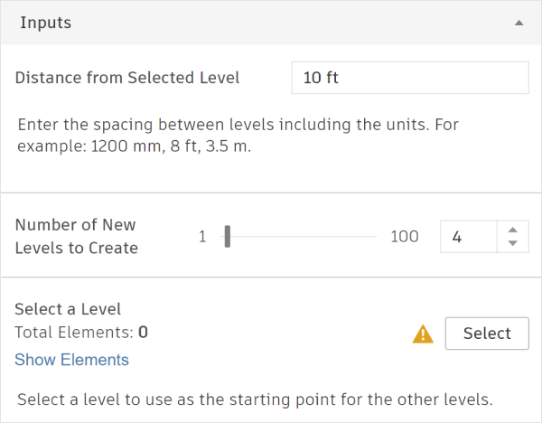

For some graphs, you only need to press the Play button to execute them. Other graphs may require you to first enter inputs or select objects in the model. The Player interface guides you through this process.
Example inputs from the Add Levels sample graph

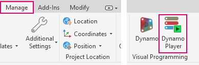

In
		  Revit, go to the Manage tab
 Dynamo Player.
Learn more about Dynamo Player
