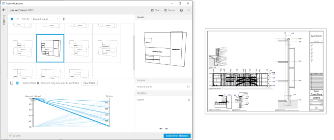

You’ll see a number of outcomes in the Explore Outcomes dialog. Select any outcome to display a larger image that you can rotate and zoom in or out to see more detail. The viewport names are included in the preview, illustrating how each option is laid out.
In the example sheet, there are a total of 5 views available. You can use filters in the parallel coordinates chart at the bottom center of the Explore Outcomes dialog to select how many views you want on the sheet. Click and drag along the axes (vertical lines) in the chart to use filters.
