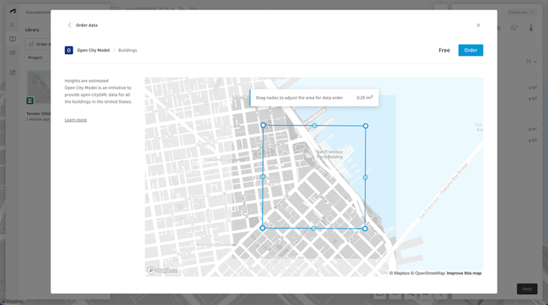

To order a data set, adjust the boundaries of the area you'd need data for by editing the blue polygon with nodes, as shown in the image below. In the top right corner, you can see the price of the data - some data sets are provided free of charge.
Click Order when you are satisfied with your selection.
After seeing a success message, you can now add the data to your project. You can choose to order another data source or go to Library.

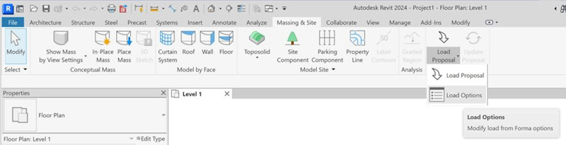

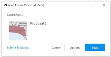

Open Revit and create a new project. In the Massing and Site tab, find the Load Proposal button.

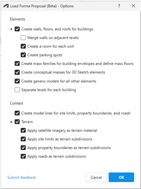

Choose your options for what kind of data you want to load into Revit.
After a few steps are completed you will have Revit things!
