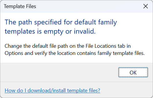

Caution: Removing essential content packs may cause revit to display the following message due to family templates not being found in the family template path specified in the Revit.ini.

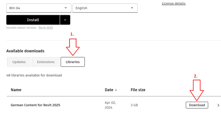

After the initial Revit install, go to Autodesk Accounts
All Products and Services
Revit
Available downloads
Libraries tab, and download the content library that you want from the list.
