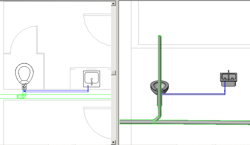

Layout panel
 Generate Placeholder . The Generate Layout tab is activated.
For our example, Standard was selected for the type of pipe and the Offset was set to 1' 6" (450 mm) for both the Main and Branch. See Pipe Conversion Settings.
The piping is created for the system piping according to your specifications in the Pipe Conversion Settings dialog.
The toilet and sink have now been assigned to a Domestic Cold Water System at the Piping level in the System Browser.
