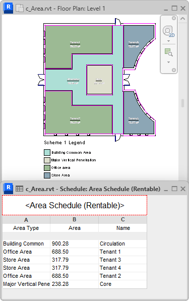

You can remove an area from its location in an area plan, leaving it available to place in another location, or delete an area from the project completely.
After creating areas, you can remove areas from a building model in the following ways:
-  Unplace: Removes the area from its location in the area plan, but the project still contains information about the area. Then you can place the area in another location later during a project redesign. See Unplace or Move Areas.
-  Delete: Completely removes the area (including all information about the area) from the project. See Delete Areas.
An area plan and an area schedule
