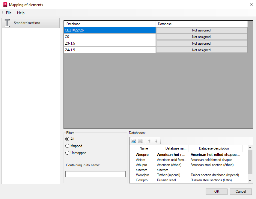

- The Mapping of elements dialog opens only if, during the transfer, section names (defined in Revit) are not recognized in the active section database of Robot.
 - Click the Not assigned button located in the right-hand side of the profile, which was not recognized. The additional dialog opens, where the profile to be assigned from the database is to be selected. Use the icons to work in the Mapping of elements dialog:    add selected database of profiles to the list. add selected database of profiles to the list.
   delete selected database of profiles from the list. delete selected database of profiles from the list.
     change order of viewing the databases of profiles (one position up/down). change order of viewing the databases of profiles (one position up/down).
- When you click OK, to the unrecognized sections will be assigned sections from the database (they will be ascribed geometrical properties).
