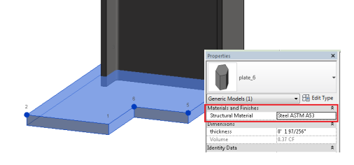

In the following example the base plate material was modified to "Steel ASTM A53" in Advance Steel. This modification was then synchronized in the Revit project. The difference is spotted as a material change. If the modification is applied, the plate material is changed according to the new value.
| Advance Steel model |   |
| Revit model sync process |   |
| Synchronized Revit model |   |
