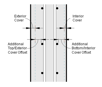

| Layout Rule | Specifies the type of rebar layout. Select either Maximum Spacing or Fixed Number. See Place a Rebar Set. |
| Additional Top/Exterior Cover Offset | Specifies an additional offset from the top/exterior rebar cover. This allows placing multiple rebar elements together in different area reinforcement layers. |
| Additional Bottom/Interior Cover Offset | Specifies an additional offset from the bottom/interior rebar cover. This allows placing multiple rebar elements together in different area reinforcement layers. |
