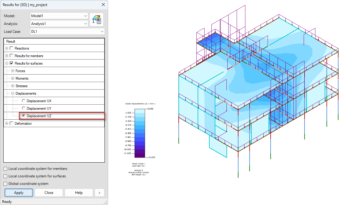

			 Results for panels (surface elements) such as Walls, Floors and Foundation Slabs
			 - Forces: Nxx (membrane force) , Nyy (membrane force), Nxy (membrane force), Qxx (shear force) and Qyy (shear force)
- Moments: Mxx, Myy, and Mxy
-  Stresses: Sxx (absolute maximum), Sxy (absolute maximum), Syy (absolute maximum), Txx (shear - middle layer) and Tyy (shear - middle layer)
- Displacements: (Ux, Uy, Uz).

- Example of displacements in the 3D analytical view
