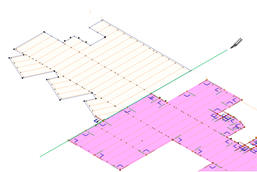

To split an analytical panel:
  1. Select an analytical panel.
  2. In the Modify | Analytical Panels contextual tab Split panel, click (Split).
  3. In your model, pick a reference along which to split the analytical panel.
    Note: The reference can be a line, an analytical member, or an edge.
