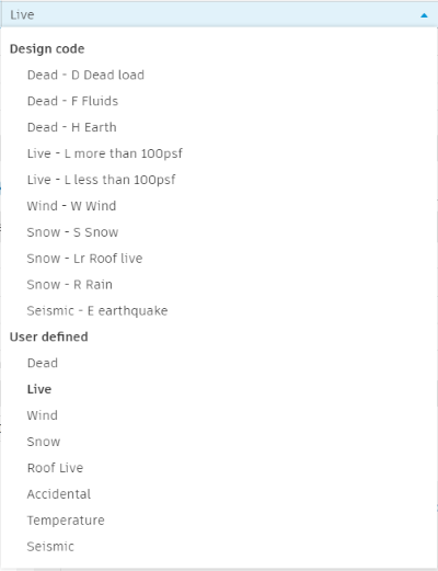

  3. Click Add.
  4. Click in the Name field and adjust the name of the load case.
  5. In the Nature column, select the appropriate Load Nature for your load case. You can choose between the load natures provided by the selected the design code, or the manually added load natures.

  3. Select the Design Code.
The load natures list will be updated with the natures provided by the selected design code.
The manually added load natures will still be available. They are differentiated from the ones provided by the design code by the Source attribute, in the second column of the table: Design Code or User Defined.

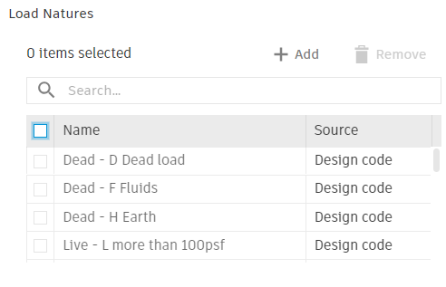

Load Natures
You can add, edit or remove load natures from the Load Natures table in the Advanced Configuration tab. You can also inspect the load natures provided by the selected design code.

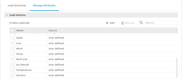

  1. Click Analyze Analytical Model (Load Cases and Combinations).
  2. Click the Manage Attributes tab.
  3. In the Load Natures table, click Add.
  4. Click in the Name field and adjust the name of the load nature.
Note: You can edit or remove manually added load natures. The load natures provided by the selected design code cannot be edited or removed. These are only updated by another design code selection.

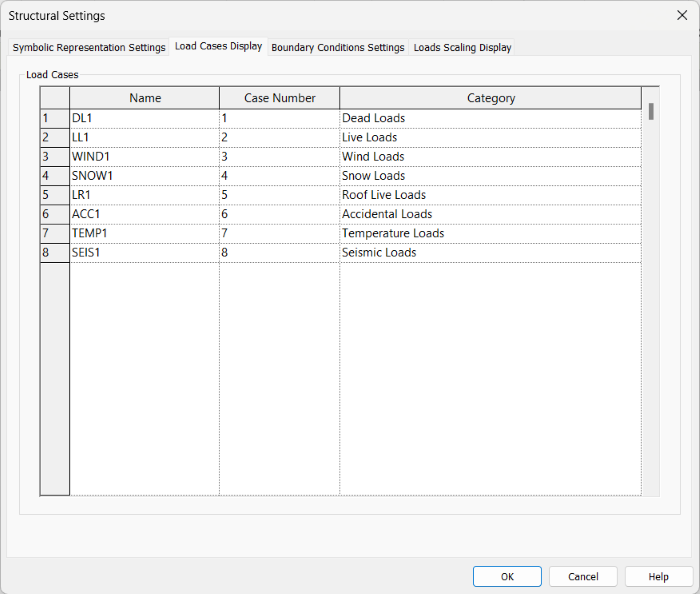

Load Cases Display
You can associate Load Cases with a predefined Category.
  1. Click Analyze Analytical Model (Load Cases Display).
  2. In the Load Cases table, Category column, select the desired Load Case predefined category for the selected load case.
Note:
  1. You can adjust each load case category representation from the Object Styles dialog. You can also add new sub-categories for load cases from here.
  2. You can override these settings from the Visibility/Graphics Overrides for each view.
  3. If you want to adjust the Load Cases list, use the Load Cases and Combinations dialog. In this dialog you can only rename the load cases and assign category to each.
