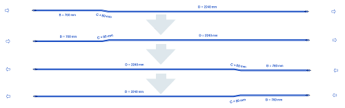

Click Modify | Structural Rebar Edit Rebar Sketch tabMode panel (Finish Edit Mode) to view the orientation of the crank.
Rotate the cranks. Select the rebar.
In the Properties palette, modify the Rotation at Start and/or Rotation at End parameters.
Click Modify | Structural Rebar tabMode panel (Edit Sketch). In the Properties palette, modify the Rotation at Start and/or Rotation at End parameters.
Click Modify | Structural Rebar tabMode panel (Edit Family). Click Modify tab Properties panel (Family Types). In the Rebar Shape Parameters dialog, modify the Rotation at Start and/or Rotation at End parameters. This changes the rotation for the cranks or hooks for all bars using this shape, once it is loaded into the project.
