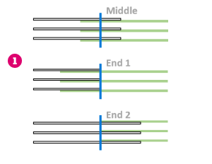

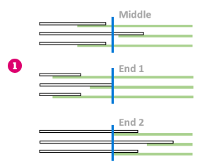

The splice position can be set for each splice instance and refers to the positioning of the splice line with respect to the lap length of the splice. The End 1 option means that the lap length is positioned towards the first set in the splice chain
| Lap splice | Staggered lap splice |
