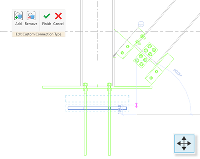

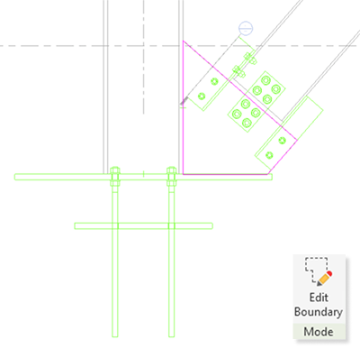

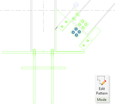

  4. While editing a custom connection:
    • You can modify the boundary of plates and contour cuts and the pattern of holes, bolts, anchors and shear studs that are part of a custom connection and are not controlled by a standard connection.
    • You can move plates, profiles, welds, bolts, anchors, and shear studs that are part of a custom connection and are not controlled by a standard connection.
    • You can only select elements from that custom connection, the other model elements are greyed out and cannot be selected.
  5. In the Edit Custom Connection Type panel, click (Finish) to accept the modifications to the custom connection, or (Cancel) to close the panel without saving changes.
