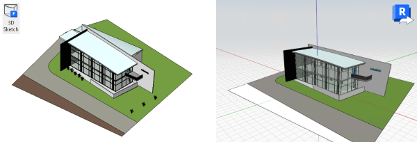

The 3D Sketch workflow now links a FormIt model to Revit for improved coordination. This is an improvement over previous versions, where models were imported, not linked, using this workflow. Launch a model in FormIt by using the 3D Sketch button in Revit, which opens the model in FormIt as a link. Once you’ve sketched a design in FormIt, send the updates back to Revit by clicking the Send to Revit button or by saving the FormIt model.

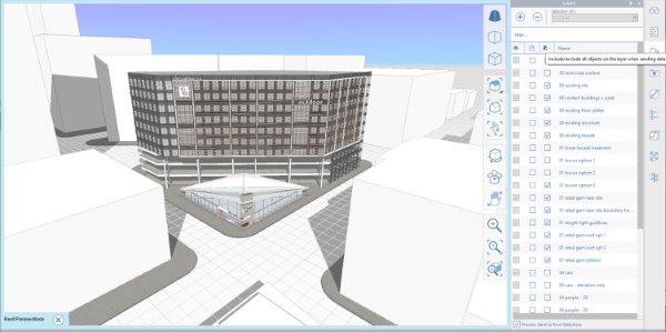

Preview the geometry and layers in FormIt that will be sent to Revit, giving you a better control over the content that will be sent back. In FormIt, enable the preview mode by using the Preview Send to Revit Selections checkbox in the Layers panel. A blue frame indicates that the Revit Preview Mode is enabled. A new column in the Layers panel indicates which layers will transfer to Revit when linking the AXM or when using the 3D Sketch – Send to Revit workflow.
