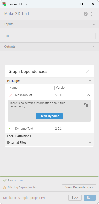

To function in Dynamo Player, a Dynamo graph may require certain dependencies, such as packages, custom nodes, or external files. You can examine each graph’s dependencies in Player through the Graph Dependencies dialog. This dialog provides a quick way to see which packages and other dependencies your graph needs in order to run properly, and it enables you to identify missing dependencies, which you can install in Dynamo.

Go to the Options menu in Dynamo Player and select Graph Dependencies. If the graph you are trying to run in Player is missing any dependencies, you will see a warning near the bottom of the Player application. You can also click this warning to open the Graph Dependencies dialog.

If the graph you have open in Dynamo Player relies on any dependencies, they will be listed in the Graph Dependencies dialog, sorted under headers:
In addition to a name and version, each dependency is accompanied by an icon.
image Graph Dependencies dialog

The Graph Dependencies dialog provides a simple way to view dependencies without having to open Dynamo. Missing dependencies can be installed in Dynamo. If dependencies are missing, the dialog will include a Fix in Dynamo button to open Dynamo and install the missing dependencies in the Workspace References extension. You can also access this extension from Dynamo by going to Extensions > Show Workspace References.

After the missing dependencies have been resolved, save the graph in Dynamo, and the Graph Dependencies dialog will refresh to show the updated dependencies.
