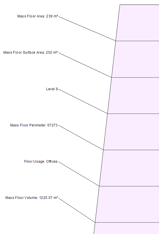

After creating mass floors, you can tag them in 2D views. The tags can include information about the area, exterior surface area, perimeter, volume, and usage for each mass floor.
If you change the shape of the mass, the tags update to reflect the changes.

To display other parameter values in a mass floor tag, create a tag family that include the desired information, as shown.
Sample tags for mass floors
